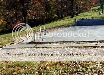

Put down about 4" of base rock. Compacted it with the tractor and a thumper I rented.
Ready for concrete. Put down a 6-mill vapor barrier. 1/2" rebar on 12" centers. The rebar wasn't that much more than wire but not near as much fun to place.
Down on my knees for about 10 hours twisting and tying all the rebar together. Then I had to put "chairs" under the rebar to hold it up while the concrete was being placed.
Slab is a full 5" thick and has a turn down footing.
The concrete crew.
Finished slab. I got some bids to take it up from the ground to this point. Since I have a lot more time than money I did it all myself and saved
about $5,000 dollars. When I got bids all of the contractors were about 3 months behind and that was another factor. The guys that did the
pour and finish were one of the original bidders. They weren't the cheapest but had the best reputation.
Concrete guys like a pour and finish job as they can get in and out in half a day and make pretty good money.
Two winters and I have a 5' long hairline crack. I think that was because one of the concrete trucks might have had a hot load.

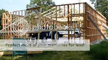

Walls going up. Built the 16' wall sections on the slab and lifted the sections up with the log forks on the tractor.
With a nail gun this part went pretty fast. Might seem strange for a guy with a sawmill to build with store bought lumber
but I got douglas fir with free delivery for .48 cents a BF. If I got a bad board I would send it back on the next delivery
and they would credit my account. No end trimming required. I like to saw grade hardwoods and leave the construction lumber to somebody else.

About time for the truss to start going up.
I left a 10' section out of the end wall so I could pick up the truss with the FEL and set them on the top plate.
Instead of a double top plate I used a single plus an outside purlin. Trusses all sit on top of a stud.
Put hurricane clip's on both the inside and outside. The clip on the outside is a different style and is long enough to attach to the stud.
Faming nearly completed.
