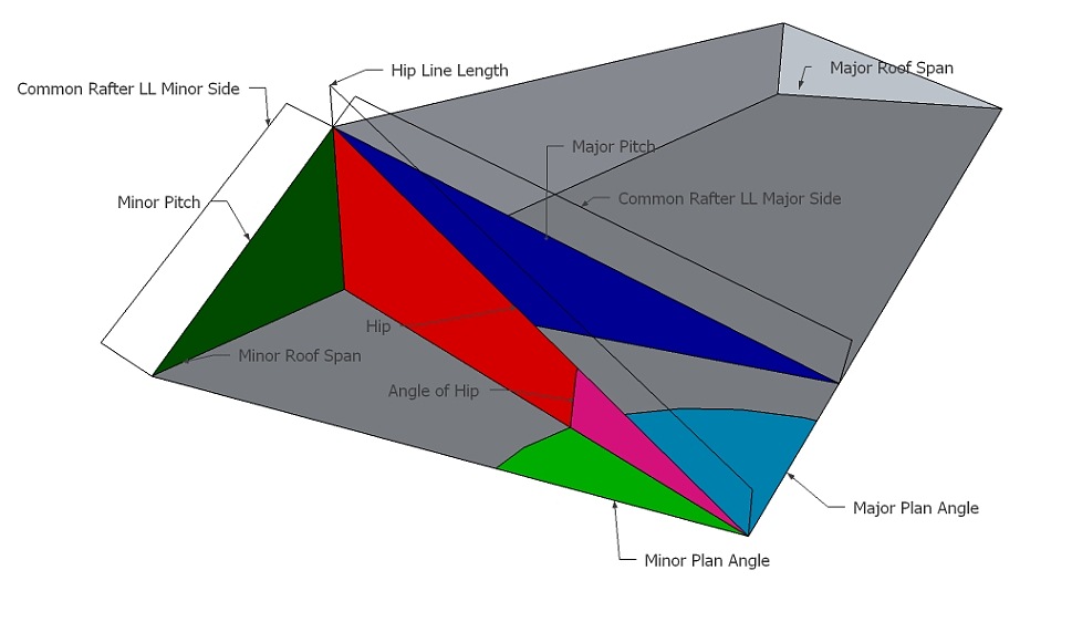

Major Side Roof Pitch Major |
Minor Side Roof Pitch Minor |
Major Side Roof Span (building width-ridge thickness)/2 |
Hip Thickness |
On Center Spacing |
Major Side Plan Angle atan(minor/major)
The Plan angles are also the cheek cut bevels
for both the Jacks and the Hip.
Minor Side Plan Angle atan(major/minor) |
Major Side Pitch Angle atan(rise/12)
pitch angle of the Major side. | |
Minor Side Pitch Angle atan(rise/12) pitch
angle of the Minor roof. |
Major Side Difference
Majordiff = (tan(majplanangle)/cos(majpitchangle))* OCspace
Minor Side Difference(Step) Amount each jack is shortened to land at the next on
center layout along the hip |
Major Side Ply Angle
majplyangl= atan(tan(majplanangle) /cos(majpitchangle))
Minor Side Ply Angle | |
Plywood Sheathing Cut Major Side majPlySheathCut = 48 / tan(minplyangle) |
Plywood Sheathing Cut Minor Side Amount to measure back from top corner of sheet to chalk
cut line. This creates the Ply Angle from above | |
Hip Seat Cut Angle Seatcut = 90 - HipAngle |
Angle of Hip
HipAngle = atan(cos(majplanangle)* tan(minpitchangle))
Backing Angle Major Side majBackAngle = atan(sin(HipAngle) / tan(minplanangle))
Backing Angle Minor Side Bevel to rip along edge of hip to have it plane with the sheathing | |
Hip Drop Major Side HipDrop = tan(BackingAngle)* 1/2 hip thickness |
Hip Drop Minor Side If the hip is not backed this is the amount to lower
the seatcut of the hip to have the corner edge of the hip plane in with the sheathing | |
Common Rafter LL Major Side majLL = (majspan * majLLratio)
majLLratio=sqrt((major*major)+144)/12 |
Common Rafter LL Minor Side minLL = rise / sin(minpitchangle) | |
Hip Line Length hiplength = rise /sin(HipAngle) |
Minor Roof Span minspan = minLL * (sqrt(1-(rise*rise)/(minLL * minLL))) This is the distance from the end
of the ridge to the building line |
