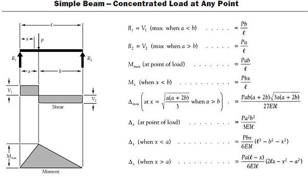

Simple Beam, Concentrated Load at Any Point
pointload
When specifying a beam or joist three things are usually considered;
First,is the beam strong enough that it doesn't fail by the fibers on the bottom being torn apart, a fiber failure.
Second, is the beam stiff enough that there will not be excessive deflection. A bouncy floor, cracked tile or plaster would be examples of this.
Third, is the beam strong enough that its fibers don't slip past one another, bend a magazine and watch the pages slide past one another. This is a horizontal shear failure.

Fiberstress in Bending Deflection Horizontal Shear
Max Moment (ft-lbs) Deflection (inches) Shear in Left Side of Beam (PSI)
Section Modulus Required Max 1/360 (Floor) Shear Pass/Fail, Left
Section Modulus Input Max 1/240 (Roof) Shear in Right Side of Beam (PSI)
Section Modulus Pass/Fail Deflection Pass/Fail Shear Pass/Fail, Right
Support Reaction, Left Support Reaction, Right
