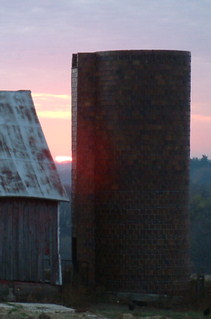

We have the kind that's clay tiles layed up with steel bands. I would like to take it down but don't have the nerve to use the excavator. Anyone have any ideas how to do it?

The story was that they had knocked out every other block in a row on one side of the silo, ran a chain around those blocks still there, then back through the center of the silo and out a small hole on the other side. They then hooked the chain to the crawler and pulled. After several tries and removing many blocks this way, the silo was still standing. Thinking they could just push it over, they drove into it. As the driver backed away, the silo followed. :o There was no mesh on top of the crawler if I remember correctly. There was however, a small tree growing up through the center ot the silo that came down on the cage and saved the driver.

Norm, I could give you a few ideas, but none are tried and true. :-/ I think it may be a bit dangerous! ;D

Crane with ball and chain would make short work of it.
Hey.......I didn't think of that one. But that would cost $$ and you wouldn't have the fun of running for your life.  ;D ;D ;D

Norm_F,  I know how you can take that silo down real fast.  8)Take a bunch of dinomite and put it in the silo and set it off with a short fuse. :o The excitement comes with trying to out run the flying rocks. ;)

Actually, explosives wouldn't be bad...  If one had a local army or national guard base around that had combat engineers.  Offer it as a training excercise.
My other idea is make a stinger for the excavator out of an I-beam with a flat plate on the end.  20feet or so plus the boom reach?  Go at it kinda high so one is not dealing with all the mass at once...  Hmmm, there may be some problems with that last part I'm not seeing... any comments?

Uhhhhhhhh, guys?  I think he may be trying to save the barn.  ::)
That may mean being a little bit more gentle then say, oh I don't know, ummm, "EXPLOSIVES"!!!!  ;D The explosives would be just fine, in the "right" hands, but I'd try the stinger or something like it first.
Of course you could blow in a bunch of dry sawdust and do a little bit of "experimenting".  ::) ;) ;) ;D

It's too close to the house and sawshed for explosives although I could do the side away from it. My concern is if I don't get it to fall with the first blast I'm screwed. I like the idea of a stinger on the end of the arm and starting up high. But the cost to fab it up would be kind of high. Even in high speed ole link don't back up very fast so I'm kind of nervous about using just the arm to try up high with it.
Still like the idea of blasting... if I could just remember where I put that C4 at. ;D

In the 60's my brother and I took down a cement block silo with 2 10 pound mauls. You start at the point you want it to fall. One man goes in one way and the other man in the other direction. You knock out each block in the row.  We were 3/4 of the way around befor it fell.
At the home farm we had a poured concrete silo taken down by an expert blaster. That silo was 3 feet from the barn. No damage.

Your a braver man than me Bill. Did you have any warning when it was getting ready to fall? I'd like to hear the story about how he did the poured concrete one. :)

Norm It wasn't being so brave. It was younger and dumber.
On the concrete silo  he laid det cord around the bottom about 2/3 of the way. Then I think that he used half stickes of dynomite and covered with crushed lime- like fine sand. This was to create a shaped charge. When it went off  it tipped right over . The man who did this used to do a lot of blasting.

I forgot your other question. No there was no warning. One swing it was standing the next it was falling.
That is the way most block is.
At work I have removed some brick and block walls . They are almost the same. You remove over half before it will fall.
