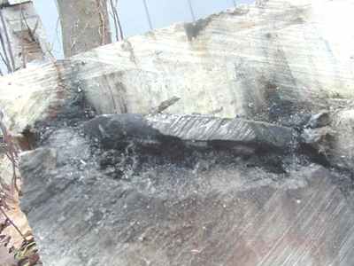

2nd log of the Day. Minimal Damage, just a set of saw teeth and a couple dinged shanks.  The Shoe nails are still in this one. You can see one sticking up near the left side of the saw marks.
I got lucky, an inch deeper and i would have hit her full bore.  I
guess if ya gotta hit a horseshoe, this is the spot to hit em. :)

Tom, yer not a circle saw guy. Hitting it that way is a GOOD thing. Hitting one of those with a band, it really dont matter where you hit it, the band is history. With the circle mill hitting a hunk of iron that size could mean THOUSANDS of dollars in damage, not just 20. As it was, the saw teeth were new of course, so it was about a 50 dollar loss for that, plus down time. Very Lucky.
Commercial circle sawmill sawyer in a past life for 25yrs.
Yeah, I know. :)   You circle mill guys are tough.  I'm not so sure my nerves could stand running a  5 thousand dollar blade through a log.  I have chest pains now when I lose the $20 blade. :D
This one made quite a racket. The blade did not hit solid but followed the edge of the shoe. I knew by the noise and the spark show, this weren't no ordinary nail. :D

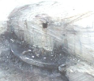

This was a 10 foot butt log. Near as I can count, the tree was about 45 years old. It was about a 15-16 inch log. This picture shows the shoe was in the tree when it was just a sapling. The pith is in the center of the shoe and the show was horizontal in the tree. This picture is the position the tree would have been in.
